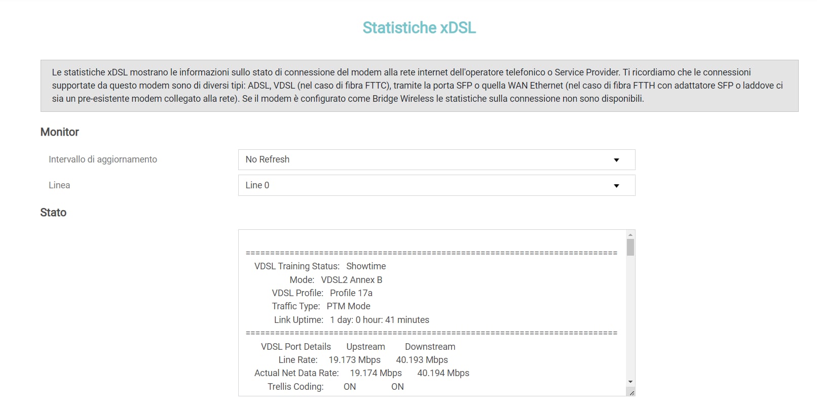

Da statistiche sul modem posso capire qualcosa in più?
Ringrazio per qualsiasi suggerimento...io non so più cosa provare
    luca_ma Da statistiche sul modem posso capire qualcosa in più?
    Puoi mandare uno screenshot delle statistiche? 😀
    Questo lo stato del traffico da modem:
    non so se è questo quello che interessa

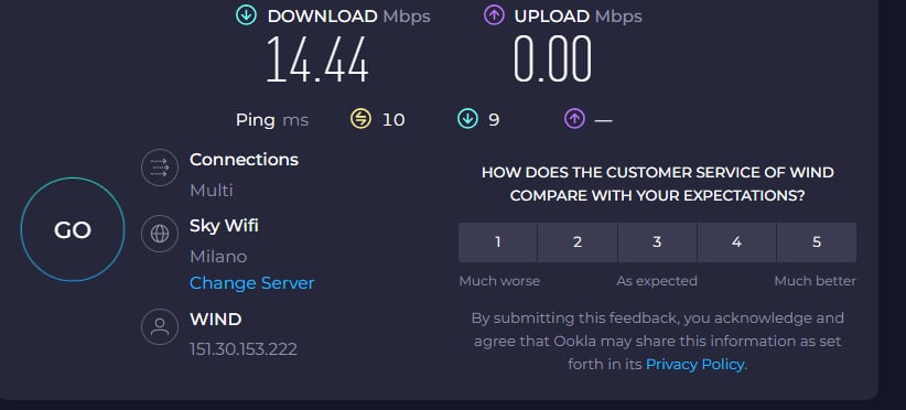

    ho appena fatto uno speed test (da https://www.speedtest.net/) e updload a 0MBps (dowload 14.44 MBps)
    grazie
      Non si legge niente, copia ed incolla tutto il contenuto di "Stato" usando il tag code
          VDSL Training Status:   Showtime
                          Mode:   VDSL2 Annex B
                  VDSL Profile:   Profile 17a
                  Traffic Type:   PTM Mode
                   Link Uptime:   1 day: 3 hours: 15 minutes
             VDSL Port Details       Upstream         Downstream
                     Line Rate:     19.173 Mbps       40.193 Mbps
          Actual Net Data Rate:     19.174 Mbps       40.194 Mbps
                Trellis Coding:         ON                ON
                    SNR Margin:        5.6 dB            6.3 dB
                  Actual Delay:          0 ms              0 ms
                Transmit Power:        8.9 dBm          14.2 dBm
                 Receive Power:      -11.2 dBm          -8.1 dBm
                    Actual INP:       58.0 symbols      60.0 symbols
             Total Attenuation:       19.2 dB           22.4 dB
            VDSL Band Status    U0      U1      U2      U3      D1      D2      D3
        Line Attenuation(dB):  5.6    34.4    57.3    63.5    17.8    43.8    71.9
      Signal Attenuation(dB):  5.6    33.9    57.5    63.9    21.3    43.6     N/A
              SNR Margin(dB):  5.9     5.6     5.6     5.6     6.3     6.3     N/A
         Transmit Power(dBm):- 5.7     2.2     6.4     1.4    13.1     7.9     N/A
                  VDSL Counters
                 Downstream        Upstream
      Since Link time = 15 min 13 sec
      FEC:		7966		2897
      CRC:		5		4
      ES:		3		3
      SES:		2		2
      UAS:		0		0
      LOS:		0		0
      LOF:		0		0
      LOM:		0		0
      Retr:		0
      FailedRetr:	0
      FailedFastRetr:	0
      Latest 15 minutes time = 6 min 17 sec
      FEC:		38		4
      CRC:		0		0
      ES:		0		0
      SES:		0		0
      UAS:		0		0
      LOS:		0		0
      LOF:		0		0
      LOM:		0		0
      Retr:		0
      FailedRetr:	0
      FailedFastRetr:	0
      Previous 15 minutes time = 15 min 0 sec
      FEC:		1		0
      CRC:		0		0
      ES:		0		0
      SES:		0		0
      UAS:		0		0
      LOS:		0		0
      LOF:		0		0
      LOM:		0		0
      Retr:		N/A
      HostInitRetr:	N/A
      FailedRetr:	N/A
      Latest 1 day time = 15 hours 36 min 17 sec
      FEC:		7596		2747
      CRC:		5		4
      ES:		3		3
      SES:		2		2
      UAS:		0		0
      LOS:		0		0
      LOF:		0		0
      LOM:		0		0
      Retr:		0
      FailedRetr:	0
      FailedFastRetr:	0
      Previous 1 day time = 24 hours 0 sec
      FEC:		13853		2573
      CRC:		2		4
      ES:		33		5
      SES:		31		4
      UAS:		64		33
      LOS:		2		4
      LOF:		4		4
      LOM:		0		0
      Retr:		1
      FailedRetr:	0
      FailedFastRetr:	0
      Total time = 1 days 15 hours 36 min 17 sec
      FEC:		39230		6687
      CRC:		12		8
      ES:		39		8
      SES:		33		6
      UAS:		97		66
      LOS:		2		4
      LOF:		4		4
      LOM:		0		0
      Retr:		1
      FailedRetr:	0
      FailedFastRetr:	0
      non mi sembra di vedere errori di fatto se faccio speed test io ottengo sempre

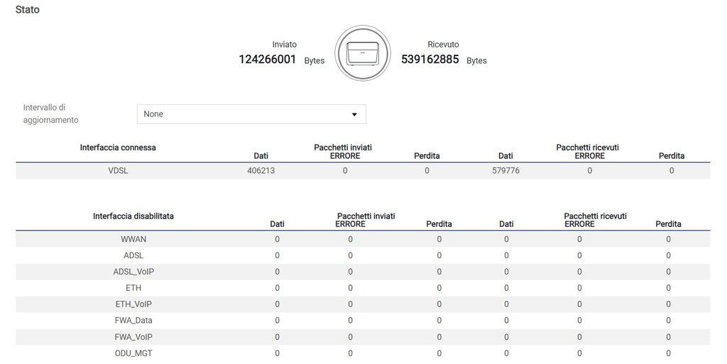

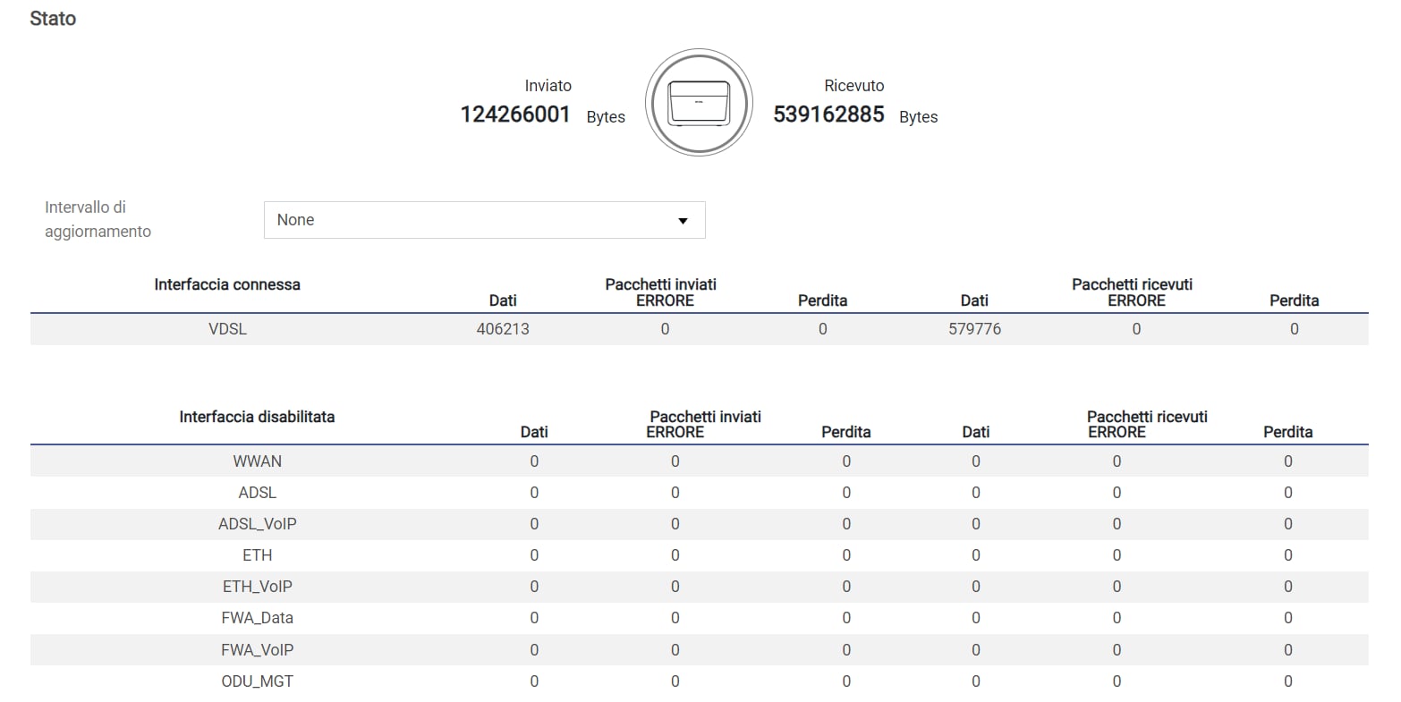

      Questo lo stato del traffico WAN
      Stato
      Inviato
      178801068
      Bytes
      Ricevuto
      725367545
      Bytes
      Intervallo di aggiornamento
      None
      Interfaccia connessa Pacchetti inviati Pacchetti ricevuti
      Dati ERRORE Perdita Dati ERRORE Perdita
      VDSL 502439 0 0 725178 0 0
      Interfaccia disabilitata Pacchetti inviati Pacchetti ricevuti
      WWAN 0 0 0 0 0 0
      ADSL 0 0 0 0 0 0
      ADSL_VoIP 0 0 0 0 0 0
      ETH 0 0 0 0 0 0
      ETH_VoIP 0 0 0 0 0 0
      FWA_Data 0 0 0 0 0 0
      FWA_VoIP 0 0 0 0 0 0
      ODU_MGT 0 0 0 0 0 0
      non mi sembra di vedere errori.

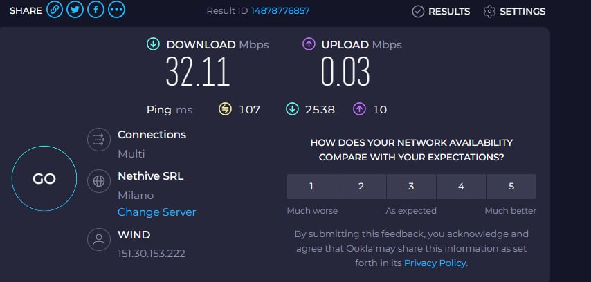

      Però se provo ad effettuare speed test da diversi device sia connessi al router tramite ethernet che wifi ottengo una banda di upload prossima a zero (a volte zero a volte 0.05 MBps) che rende la mia connessione di fatto inutilizzabile

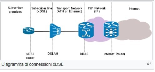

        Scusa la mia ignoranza cosa significano W3 e BRAS?
        grazie ancora
        buona giornata
        luca
        luca_ma
        mi pare che il BRAS (Broadband Remote Access Server)
        sia un apparato all'interno della rete del provider, quindi non dovrebbe essere un problema dell'ultimo miglio in rame
        grazie per approfondimento
          luca_ma mi pare che il BRAS (Broadband Remote Access Server)
          esattamente , è quello che solitamente viene chiamato circuito logico e che è in gestione a W3 che sta per Wind3 , tecnicamente se non ricordo male ( e in quel caso chiedo venia ) mi pare di ricordare che il BRAS dovrebbe essere quel punto della rete logica dove viene configurato anche il profilo della velocità e che in casi di problemi come quello da te riscontrato ma non solo ( ti porto un esempio https://forum.fibra.click/d/41488-wind3-fttc-in-disservizio ) potrebbe dipendere da una configurazione fatta male o un errore , se hai mandato una PEC ieri sera allora attendi la risposta che sicuramente dovrebbe arrivare da reparti piu specifici gli operatori al massimo arrivano a vedere la velocità di allineamento con l ONU che è quella che vedi te sul modem ( 40194*19174 )

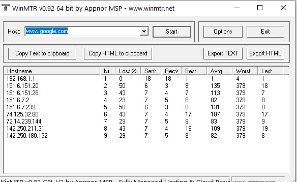

            luca_ma non mi sembra di vedere errori.
            Fai un MTR o una serie di MTR su varie direttrici, vediamo se si evidenzia qualcosa a livello IP.

              luca_ma
              Hai del loss da paura, giustamente e sin dal primo hop.
