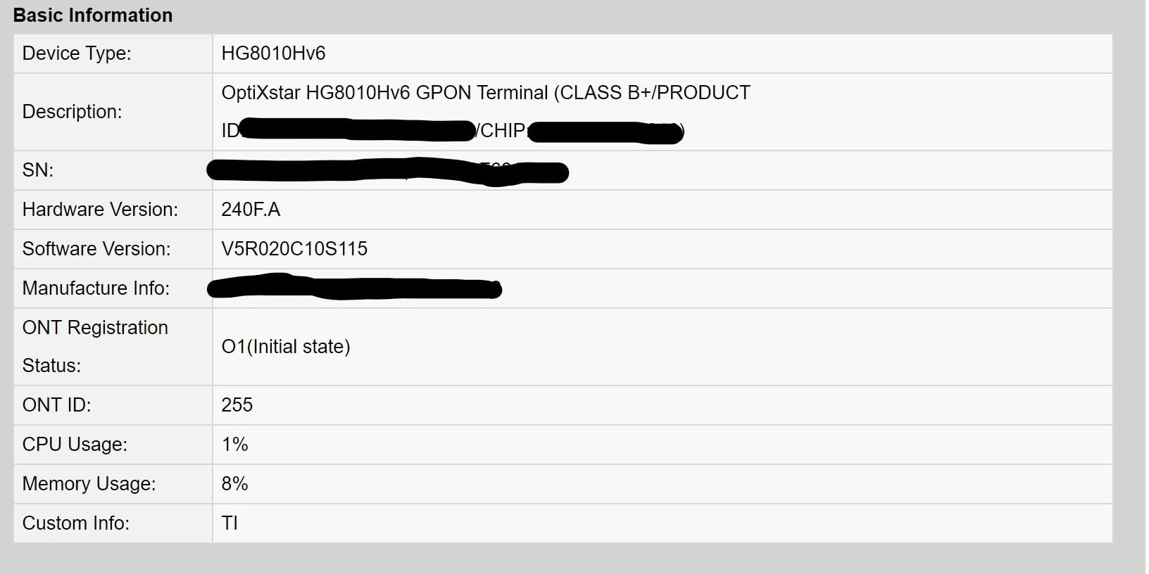

                              Ti riporto tutto il log che magari ci vedi qualcosa di interessante...
                              Manufacturer:Huawei Technologies Co., Ltd;
                              ProductClass:HG8010Hv6;
                              SerialNumber:;
                              IP:192.168.100.1;
                              HWVer:240F.A;
                              SWVer:V5R020C10S115;
                              1970-01-01 00:00:00 [Error][Alarm-Log] AlarmID:104001,AlarmLevel:Error,Device reset. Cause: System reset after being powered on, Terminal:OTHER
                              1981-01-01 00:01:16 [Error][Alarm-Log] AlarmID:104509,AlarmLevel:Error,Software upgrading.Terminal:OTHER
                              1981-01-01 00:01:26 [Error][Alarm-Log] AlarmID:104510,AlarmLevel:Error,Software successfully upgraded. Source version: V500R020C10SPC024B001. Target version: V500R020C10SPC025B002.Terminal:OTHER
                              1981-01-01 00:04:01 [Error][Alarm-Log] AlarmID:104509,AlarmLevel:Error,Software upgrading.Terminal:OLT
                              1981-01-01 00:05:55 [Error][Alarm-Log] AlarmID:104510,AlarmLevel:Error,Software successfully upgraded. Source version: V500R020C10SPC025B002. Target version: V500R020C10SPC115B270.Terminal:OLT
                              1981-01-01 00:06:06 [Error][Alarm-Log] AlarmID:104001,AlarmLevel:Error,Device reset. Cause: [0], Terminal:OLT
                              1981-01-01 00:00:29 [Critical][Config-Log] Terminal:WEB(192.168.100.10),Result:Success,Type:Login,Username:root
