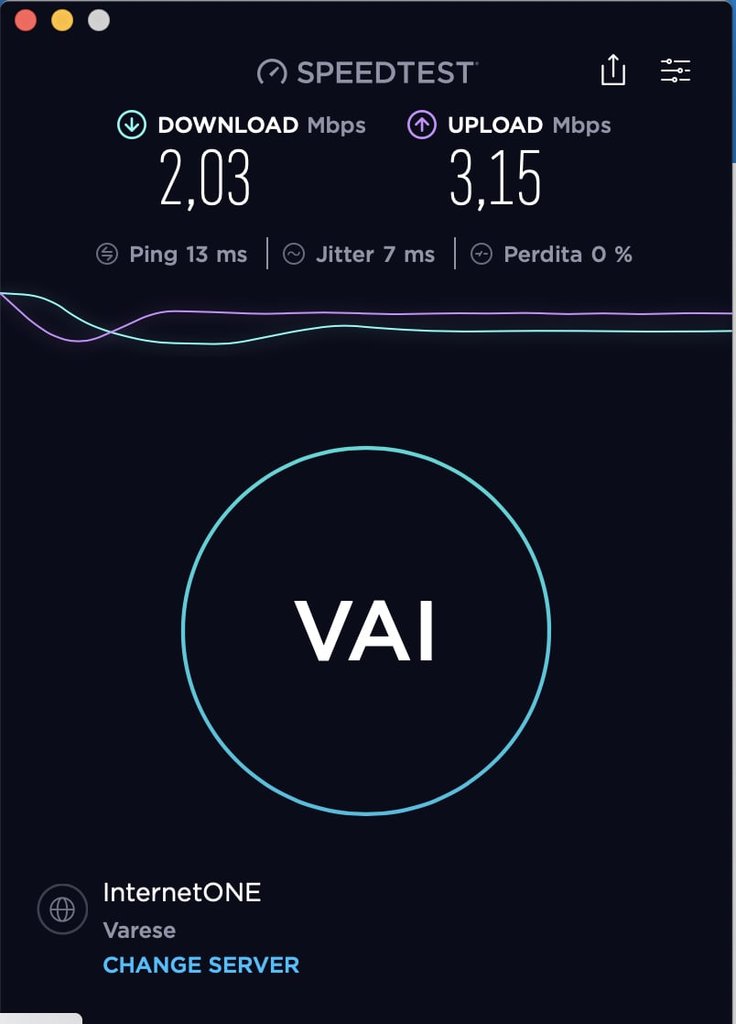

                      Questa sera
                                                          My traceroute  [v0.93]
                      DESKTOP(172.19.139.64)                                                      2021-03-13T21:32:12+0100
                      Keys:  Help   Display mode   Restart statistics   Order of fields   quit
                                                                                  Packets               Pings
                       Host                                                     Loss%   Snt   Last   Avg  Best  Wrst StDev
                       1. DESKTOP.mshome.net                                     0.0%  1281    0.2   0.2   0.2   1.8   0.2
                       2. 192.168.0.1                                            0.0%  1281    1.1   1.3   0.7  16.1   1.6
                       3. pppoe-server.net.ngi.it                                0.5%  1281   22.8 184.4   8.3 1532. 224.2
                       4. 10.222.130.74                                          0.3%  1281   36.7 189.9  16.9 1503. 220.7
                       5. 209.85.149.6                                           0.8%  1281  113.8 185.3  15.7 1367. 216.3
                       6. 74.125.245.225                                         0.2%  1281   28.0 185.7  15.9 1415. 222.4
                       7. 108.170.232.169                                        0.9%  1280  183.8 187.7  15.7 1608. 225.2
                       8. dns.google                                             0.9%  1280  197.8 185.6  16.3 1540. 222.3
                      Speedtest a circa 1/2Mbit/s in DL e 3 in UL con Eolo 30 su pannelli medusa.
