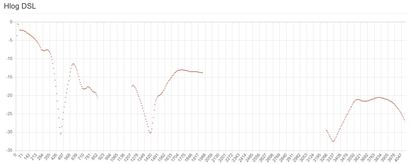

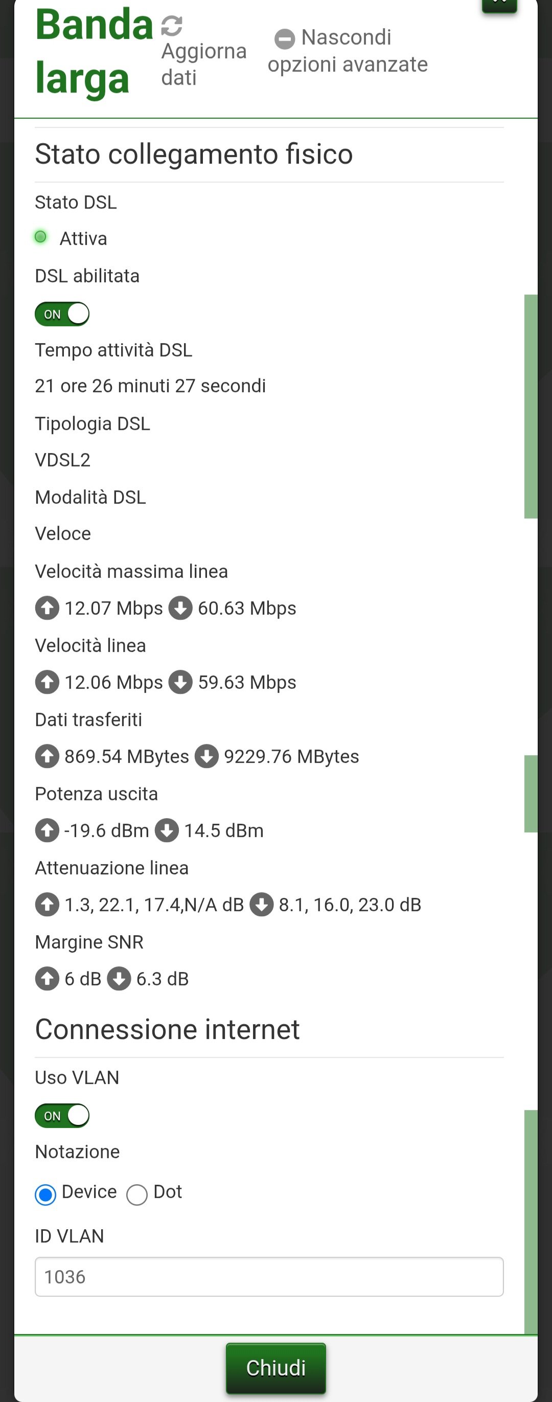

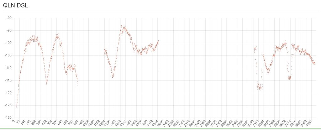

Sono riuscito a vedere tramite la shell che il profilo è 17a, per cambiarlo bisogna sentire Vodafone?

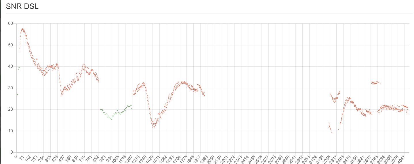

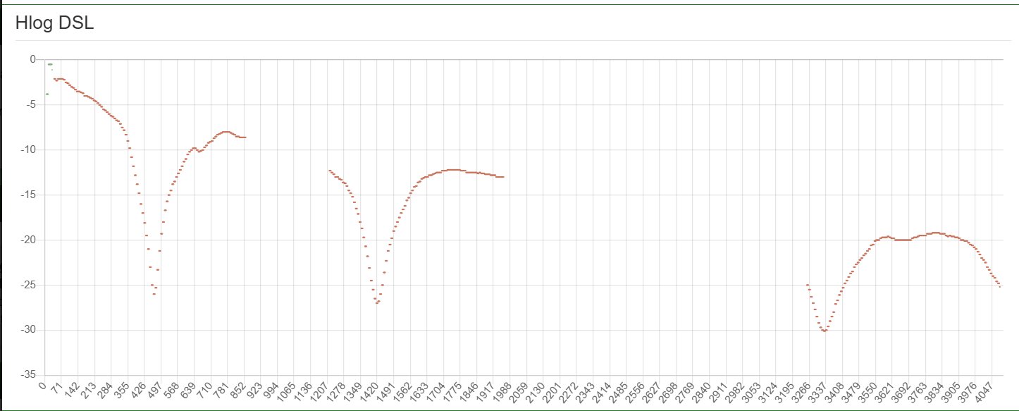

Comunque queste sono le statistiche
`root@modemtim:~# xdslctl info --show
xdslctl: ADSL driver and PHY status
Status: Showtime
Last Retrain Reason: 0
Last initialization procedure status: 0
Max: Upstream rate = 12070 Kbps, Downstream rate = 60617 Kbps
Bearer: 0, Upstream rate = 12066 Kbps, Downstream rate = 59634 Kbps
Bearer: 1, Upstream rate = 0 Kbps, Downstream rate = 0 Kbps
Link Power State: L0
Mode: VDSL2 Annex B
VDSL2 Profile: Profile 17a
TPS-TC: PTM Mode(0x0)
Trellis: U😮N /D😮N
Line Status: No Defect
Training Status: Showtime
Down Up
SNR (dB): 6.4 6.0
Attn(dB): 12.0 0.0
Pwr(dBm): 14.5 -19.6
VDSL2 framing
Bearer 0
MSGc: -6 -6
B: 243 227
M: 1 1
T: 0 0
R: 10 16
S: 0.1303 0.6010
L: 15596 3248
D: 8 4
I: 254 244
N: 254 244
Q: 8 4
V: 0 0
RxQueue: 60 25
TxQueue: 12 5
G.INP Framing: 18 18
G.INP lookback: 12 5
RRC bits: 24 24
Bearer 1
MSGc: 122 58
B: 0 0
M: 2 2
T: 2 2
R: 16 16
S: 8.0000 16.0000
L: 32 16
D: 1 1
I: 32 32
N: 32 32
Q: 0 0
V: 0 0
RxQueue: 0 0
TxQueue: 0 0
G.INP Framing: 0 0
G.INP lookback: 0 0
RRC bits: 0 0
Counters
Bearer 0
OHF: 0 0
OHFErr: 0 0
RS: 2365343480 514746833
RSCorr: 626 1571
RSUnCorr: 0 0
Bearer 1
OHF: 4815377 4834211
OHFErr: 0 1
RS: 38522521 19336845
RSCorr: 6 42
RSUnCorr: 0 0
Retransmit Counters
rtx_tx: 59 297
rtx_c: 39 286
rtx_uc: 0 0
G.INP Counters
LEFTRS: 0 0
minEFTR: 59638 12062
errFreeBits: 70352937 14231359
Bearer 0
HEC: 0 0
OCD: 0 0
LCD: 0 0
Total Cells: 280216255 0
Data Cells: 153640914 0
Drop Cells: 0
Bit Errors: 0 0
Bearer 1
HEC: 0 0
OCD: 0 0
LCD: 0 0
Total Cells: 0 0
Data Cells: 0 0
Drop Cells: 0
Bit Errors: 0 0
ES: 0 0
SES: 0 0
UAS: 26 26
AS: 77348
Bearer 0
INP: 61.00 57.00
INPRein: 0.00 0.00
delay: 0 0
PER: 0.00 0.00
OR: 0.01 0.01
AgR: 59694.75 12092.82
Bearer 1
INP: 2.00 4.00
INPRein: 2.00 4.00
delay: 0 0
PER: 16.06 16.06
OR: 63.75 31.87
AgR: 63.75 31.87
Bitswap: 27/27 6701/6701`
