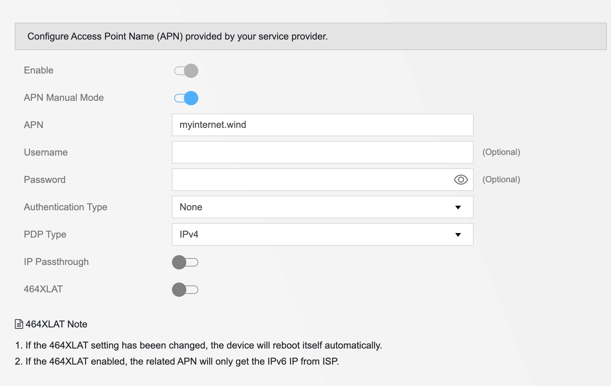

Currently, my NR7302 is set up in VLAN2 with APN2 in IP Passthrough mode and APN1 disabled. Previously, I also tried IP Passthrough with APN1 as well as the standard router mode.
