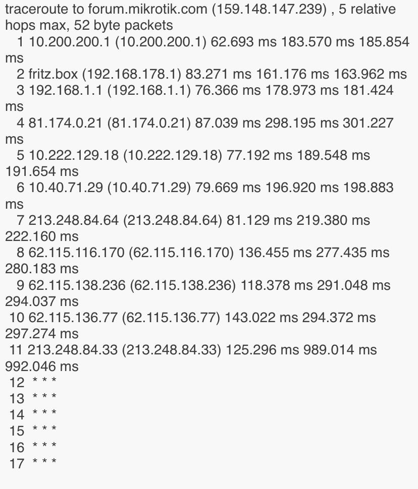

                muore in telia.
                Sarebbe interessante vedere se altri con transit su telia lo raggiungono o il tracert di qualcun altro su eolo 100.
                P.s. Quei ping.. spero che prenda male il 4G.. perchè non li ho neanche su iliad che esce in francia per tornare su vpn aziendale a bergamo e uscrire su internet di nuovo a milano (90-100 ms)😄

                                                                                                                                                           Packets               Pings
                                                                                                                                                           Packets               Pings
                   Host                                                                                                                                  Loss%   Snt   Last   Avg  Best  Wrst StDev
                   1. 81.174.0.21                                                                                                                         0.0%    48   19.5  14.9   4.6  43.2   6.8
                   2. (waiting for reply)
                   3. 213.248.84.64                                                                                                                       2.1%    47   16.0  21.4   8.8  69.3  11.8
                   4. 62.115.116.170                                                                                                                      2.1%    47   72.8  68.9  55.1 128.0  10.8
                   5. 62.115.138.236                                                                                                                      0.0%    47   67.0  68.3  53.3 183.5  19.1
                   6. 62.115.136.77                                                                                                                       0.0%    47   61.1  67.6  52.5 155.7  18.1
                   7. 213.248.84.33                                                                                                                       0.0%    47   60.1  67.1  54.3 118.2  13.1
                   8. (waiting for reply)
                   9. (waiting for reply)
                  10. (waiting for reply)
                  11. 159.148.147.239                                                                                                                     0.0%    47   57.2  68.8  53.6 130.8  11.7
                  Abilitando i vari reverse lookup:
                                                                                                                                                          Packets               Pings
                   1. pppoe-server.net.ngi.it                                                                                                             0.0%    77   22.6  15.1   4.6  43.2   6.7
                   3. mno-b3-link.ip.twelve99.net                                                                                                         1.3%    77   17.2  21.0   8.8  69.3  10.2
                   4. ffm-bb1-link.ip.twelve99.net                                                                                                        1.3%    77   67.3  68.2  54.9 128.0   9.7
                   5. s-bb3-link.ip.twelve99.net                                                                                                          0.0%    77   72.4  66.1  53.3 183.5  15.8
                   6. riga-b1-link.ip.twelve99.net                                                                                                        0.0%    77   55.6  65.8  52.5 155.7  15.2
                   7. telialatvija-ic332270-riga-b1.ip.twelve99-cust.net                                                                                  0.0%    77   73.6  67.4  54.3 118.2  11.6
                  11. forum.mikrotik.com                                                                                                                  0.0%    76   68.8  69.1  53.6 130.8  10.9

                                                       My traceroute  [v0.93]
                  DESKTOP (172.24.180.3)                                                      2021-03-03T22:09:49+0100
                                                                               Packets               Pings
                   1. DESKTOP.mshome.net                                     0.0%    51    0.7   0.6   0.2   1.3   0.2
                   2. 192.168.0.1                                            0.0%    51    1.8   1.6   0.9   3.2   0.4
                   3. pppoe-server.net.ngi.it                                0.0%    50   39.2  16.6   9.9  39.2   6.7
                   4. 10.222.130.74                                          0.0%    50   21.9  24.3  18.0  90.5  11.0
                   5. 10.40.71.29                                            0.0%    50   19.7  22.5  18.4  51.0   5.1
                   6. mno-b3-link.ip.twelve99.net                            0.0%    50   24.5  24.5  17.0 100.3  11.5
                   7. ffm-bb1-link.ip.twelve99.net                           0.0%    50   63.9  68.9  58.6 154.8  13.8
                   8. s-bb3-link.ip.twelve99.net                             0.0%    50   64.6  70.1  62.9 104.2   8.1
                   9. riga-b1-link.ip.twelve99.net                           0.0%    50   70.3  69.8  61.2  85.4   5.7
                  10. telialatvija-ic332270-riga-b1.ip.twelve99-cust.net     0.0%    50   80.7  68.1  61.3  80.7   3.8
                  11. (waiting for reply)
                  12. (waiting for reply)
                  13. (waiting for reply)
                  14. forum.mikrotik.com                                     0.0%    50   64.6  68.3  63.1  89.9   4.7
                  Anche da TIM comunque il tracroute si perde dentro telia però il sito carica.
