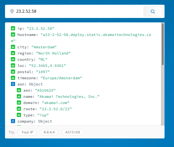

Ho provato ad aprire sky go e secondo il pihole risolve ethaneurope.it.imageservice.sky.com
[edoardo@edoardo-pc ~]$ ping ethaneurope.it.imageservice.sky.com
PING e5591.a.akamaiedge.net (23.2.52.58) 56(84) bytes of data.
64 bytes from a23-2-52-58.deploy.static.akamaitechnologies.com (23.2.52.58): icmp_seq=1 ttl=52 time=36.1 ms
64 bytes from a23-2-52-58.deploy.static.akamaitechnologies.com (23.2.52.58): icmp_seq=2 ttl=52 time=36.6 ms
64 bytes from a23-2-52-58.deploy.static.akamaitechnologies.com (23.2.52.58): icmp_seq=3 ttl=52 time=36.6 ms
64 bytes from a23-2-52-58.deploy.static.akamaitechnologies.com (23.2.52.58): icmp_seq=4 ttl=52 time=36.4 ms
^C
--- e5591.a.akamaiedge.net ping statistics ---
4 packets transmitted, 4 received, 0% packet loss, time 3002ms
rtt min/avg/max/mdev = 36.128/36.427/36.590/0.188 ms
Quindi direi di si 🙂
